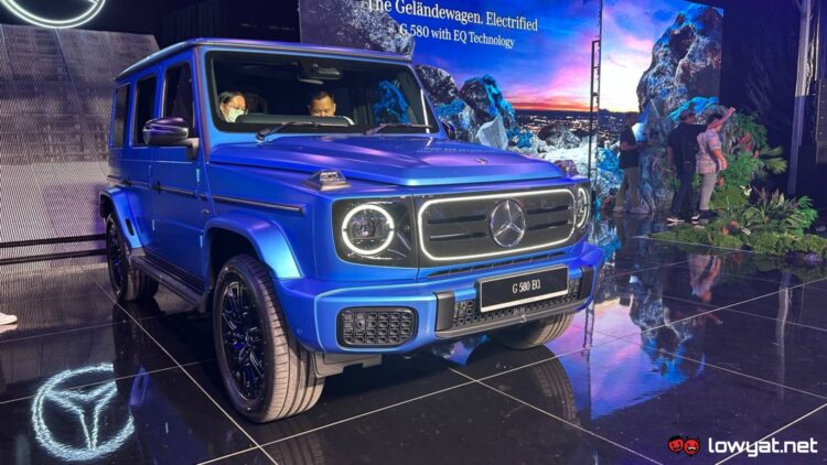

Mercedes-Benz has issued a recall in the United States involving every 2025 Mercedes-Benz G580 EQ, following concerns related to its wheel bolts. The recall, first highlighted by InsideEVs and documented through the National Highway Traffic Safety Administration (NHTSA), affects 3,734 units currently on the road.
According to the recall filing, the existing wheel bolts may “allow a wheel to loosen or detach from the vehicle” under certain conditions. The issue stems from the fact that the electric G580 uses the same wheel assembly and bolts as its combustion-powered G-Class counterparts, despite the EV’s higher mass and increased torque output.
Mercedes-Benz noted that internal analysis conducted between September 2024 and January 2025 determined that the bolts were “not adapted” to the additional stresses introduced by the electric drivetrain. Testing showed that, over time, the bolts could loosen, particularly when subjected to repeated rough driving conditions combined with frequent wheel changes.
