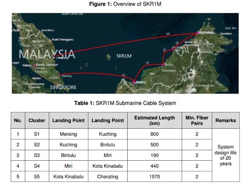

Specifically though, SKR1M will essentially become the primary backbone link between major cities in West and East Malaysia. Said to be build using the latest 100Gbps Dense Wavelength Division Multiplexing technology, the fiber-optic network will initially has a capacity of 4Tbps which can then be upgraded to 12.8Tbps later on.
Related Article TM Keen To Participate In SALAM Submarine Cable Project
Sistem Kabel Rakyat 1Malaysia
The network itself will feature five clusters that start from Mersing in Johor which then will connect to Kuching in Sarawak before the link continues to Bintulu, Miri, and Kota Kinabalu before crossing over the South China Sea again to Cherating in Pahang. In total, SKR1M will cover a total distance of 3,500 km.

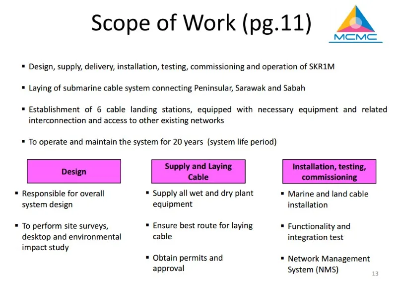

Being the chosen company that will be in charge of SKR1M, TM’s responsibility (shown above) is not limited to the deployment of the physical cable but also building six submarine cable landing stations for the project. In addition to that, TM will be operating and maintaining the network for “up to 20 years” which is the required life span as specified by MCMC.
