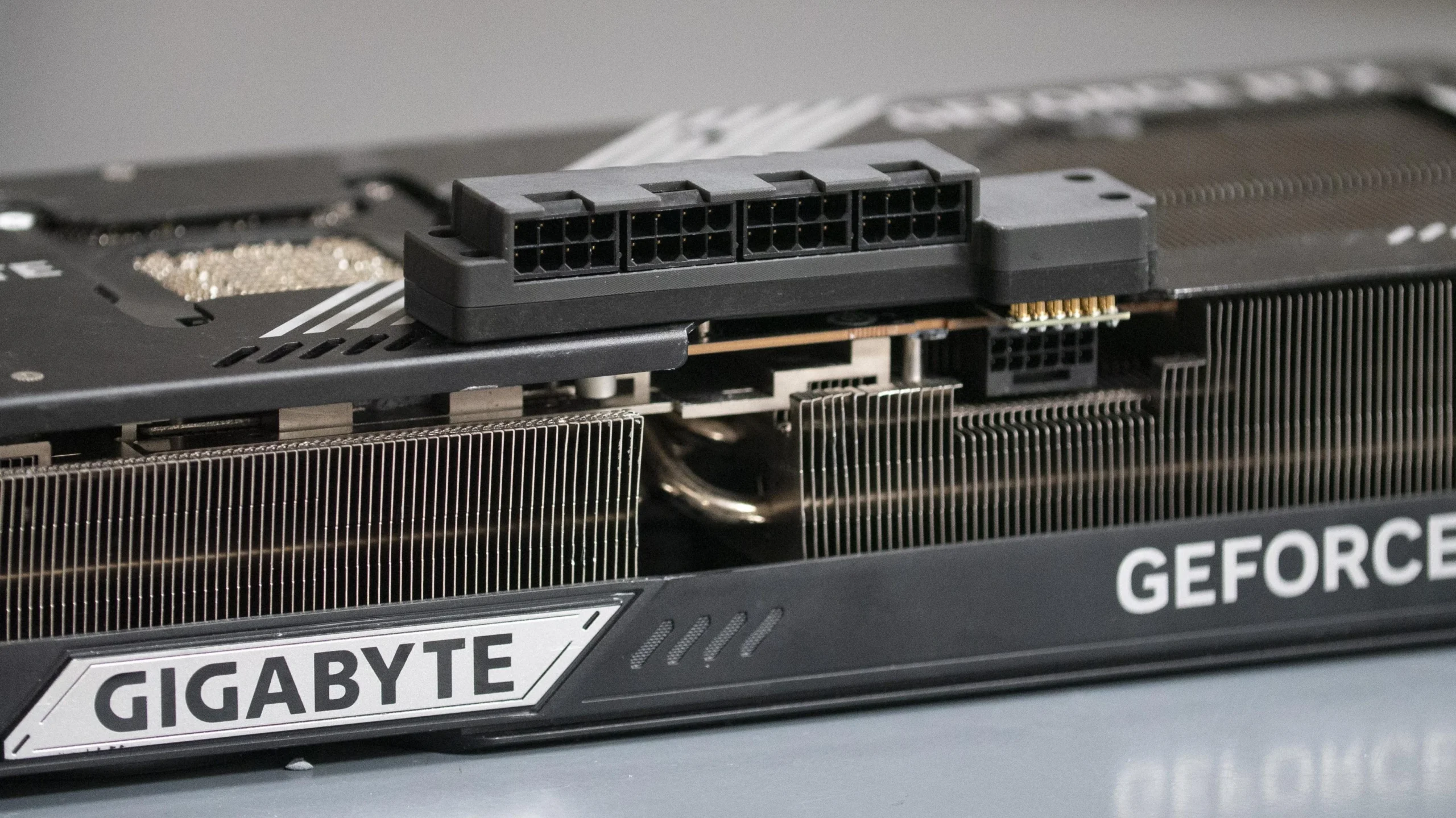

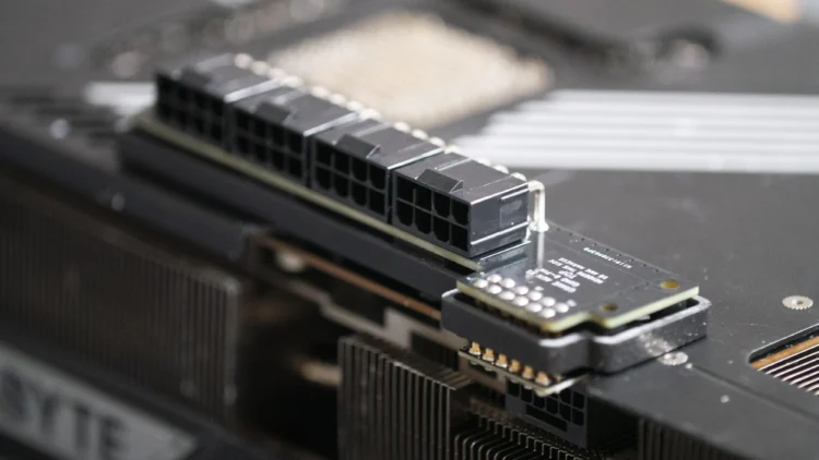

Modder and Redditor DallasGrave recently posted their modding efforts on Reddit, where they replaced the 16-pin 12VHPWR power connector on their Gigabyte RTX 5090 with four 8-pin PCIe Power ports. Well, we say replace, but it’s more a modification that mounts those 8-pins directly onto a custom PCB, while
“Some of you may have seen the remote mounted dual 8 Pin auxiliary module I posted. Well, this is the direct mount Quad. Current per conductor is almost perfectly halved when compared to the native 12V-2×8, along with a dramatic reduction in wire temperature.”

“Sense pins are set to 600W. It can be used in conjunction with the 12VHPWR or completely standalone, and has been tested up to 800W with a shunt mod. We’re shooting some videos now going over installation, live temperature and current data, as well as a 24 hour sustained load.”
Just to be clear, the additional four 8-pins to the RTX 5090 can be used independently or alongside the RTX 5090’s 12VHPWR connector. As per Dallas’ explanation, the mod basically uses fused connections and equal length PCB traces to distribute current throughout the card. Dallasgrave also says that they are working on the same mod for different GPUs, including NVIDIA Founders Edition models.
