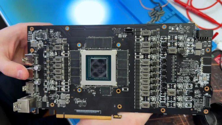

One of the fake RTX 4090 cards that Vik-Off got came from a customer who had supposedly purchased it for 30,000 rubles, which is about RM1,440. The card was being sold as a “repair project”, which is slang for cards that could potentially be restored to working order, provided you have the technical know-how to do so.
Fake RTX 4090 Looks Almost Real 2
Image: Videocardz.
Of course, the seller cum scammer of the fake RTX 4090 made it all the more difficult for them to determine its authenticity by selling it as a bare-naked PCB; they have no cooling solution attached to it, which makes it difficult for the buyer to verify if it actually works.

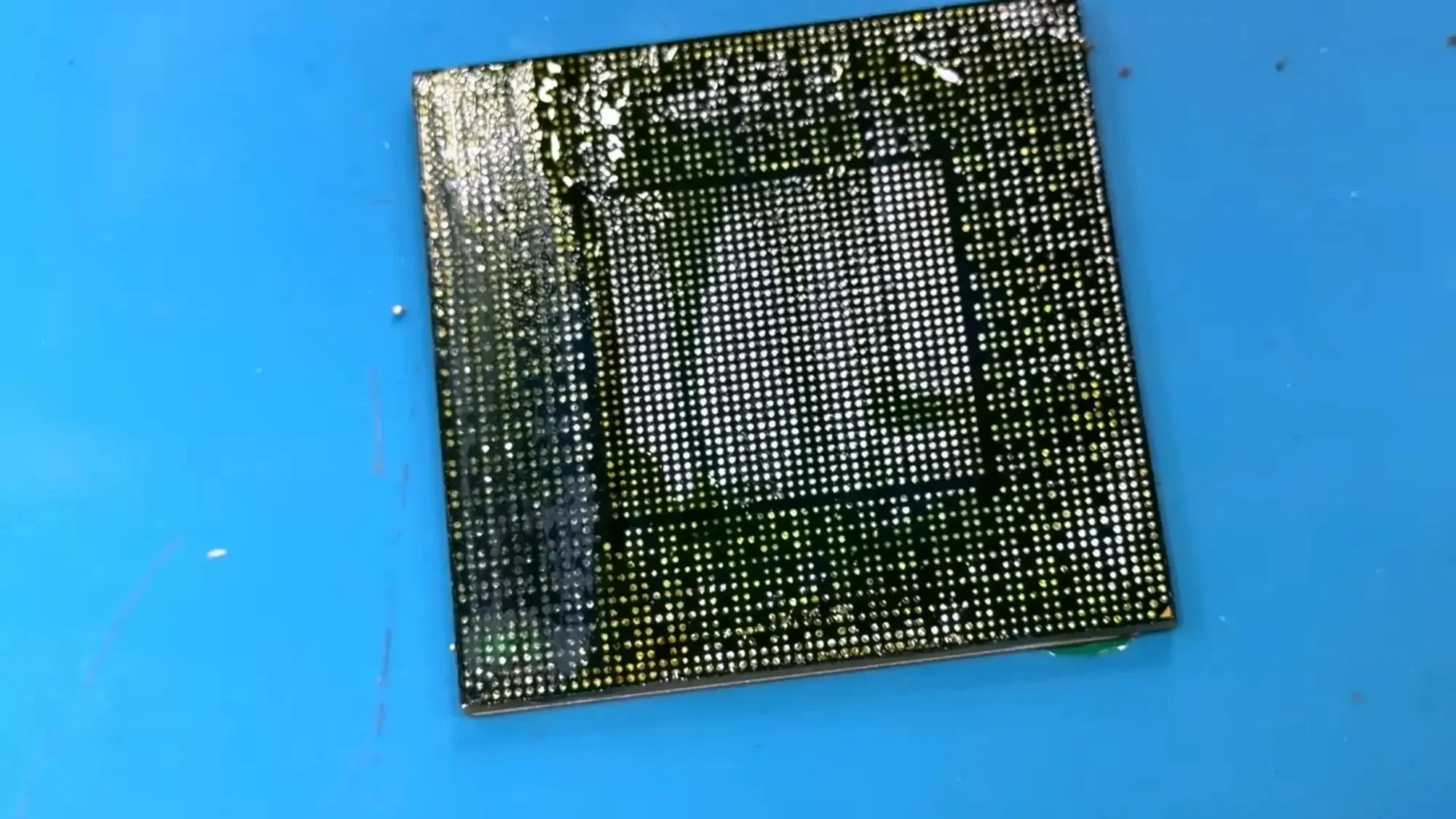

At this stage, you’re probably thinking that this sort of scam is nothing new, and you’d be right, even if you were to get in close and look at the finer details. And that’s the problem: Vik-Off said that the counterfeits were so carefully assembled to resemble an RTX 4090 board, even they’d have problems identifying it as a glance. Even the “GPU core” was soldered in place using a Ball Grid Array (BGA), instead of the typical slapping some glue to hold it in place.
Fake RTX 4090 Looks Almost Real 3
Image: Videocardz.

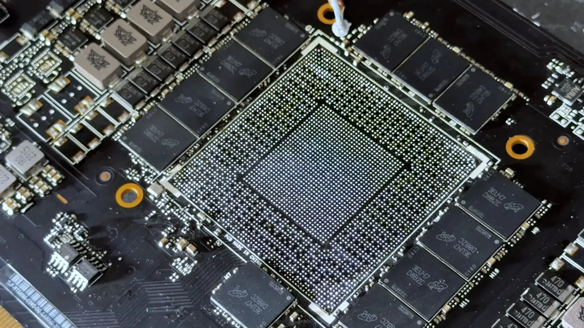

It wasn’t until Vik-Off began removing the components on the card that they were able to come to the conclusion that the customer had been duped. The GPU substrate colour, surface reflections, and lettering were off, and when they desoldered the GPU core, they found that the contact area did not resemble anything similar to a functional processor. Not only that, but the solder mask also began to deteriorate during cleaning. In short: there was no evidence of an actual RTX 4090 silicon.
Related Article Redditor Nearly Loses RTX 4090 12VHPWR Adapter To Burnout Despite Limiting Power
It didn’t end with the GPU die either. Upon further inspection, Vik-Off also discovered that the VRAM around the core were GDDR6, instead of GDDR6X modules that are paired with an RTX 4090.
