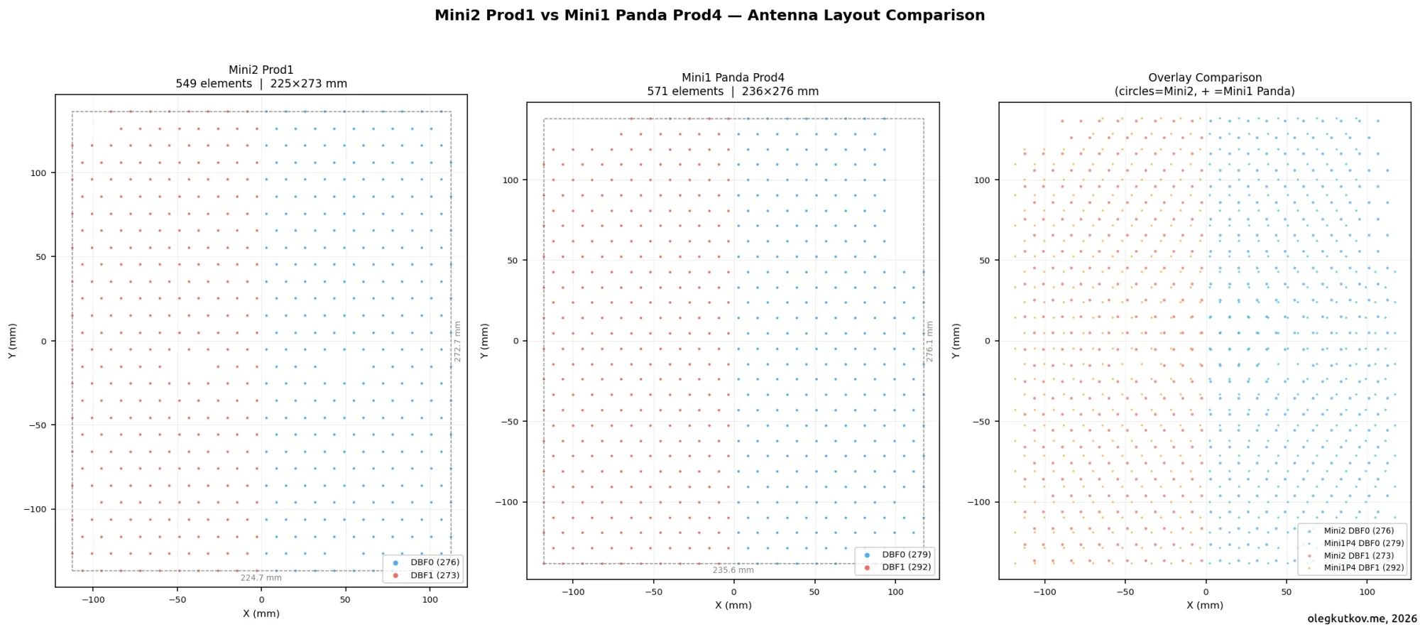

According to the leak, the Mini 2 is slightly more compact than the existing model. Its internal panel PCB reportedly measures 225 × 273 mm, compared to 236 × 276 mm on the original Mini. Despite the smaller footprint, the terminal continues to use the same Catapult system-on-chip (SoC) found in its predecessor.
