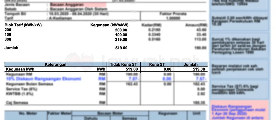

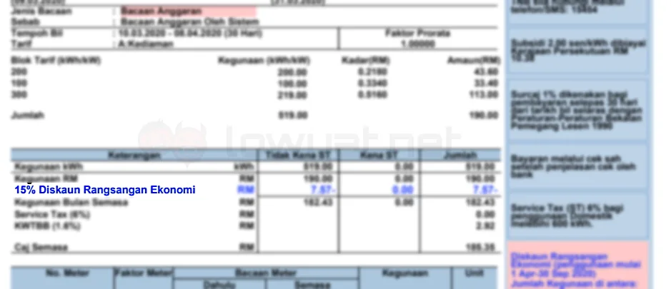

The tiered discount is meant to provide financial relief especially for users within the B40 income group. Given that we are already in the tail end of the month, it is likely that you already receive your TNB bill for April and has noticed the “Diskaun Rangsangan Ekonomi” label in it.
But at a glance, the discount might not seem right, isn’t it?
prihatin discount 01
Well, for starters, the actual bill period covered by your April bill is likely to start sometime in March instead of this month itself. Take my own home bill for April as an example which covers a duration of 30 days from 10 March until 8 April.
prihatin discount 02
Then, there is also the fact the PRIHATIN discount is only applicable for electricity consumption starting from 1 April onwards. In reference to my home bill, that means there is no discount on my usages from 10 until 31 March.
Additionally, the PRIHATIN discount rate that is being automatically applied to customers’ bill is based on their total monthly consumption as per what I’ve pointed earlier. Since TNB does not perform on-site meter reading during MCO, the company is using the previous consumption figure as the foundation to calculate the charges for the bill in April.

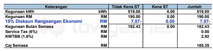

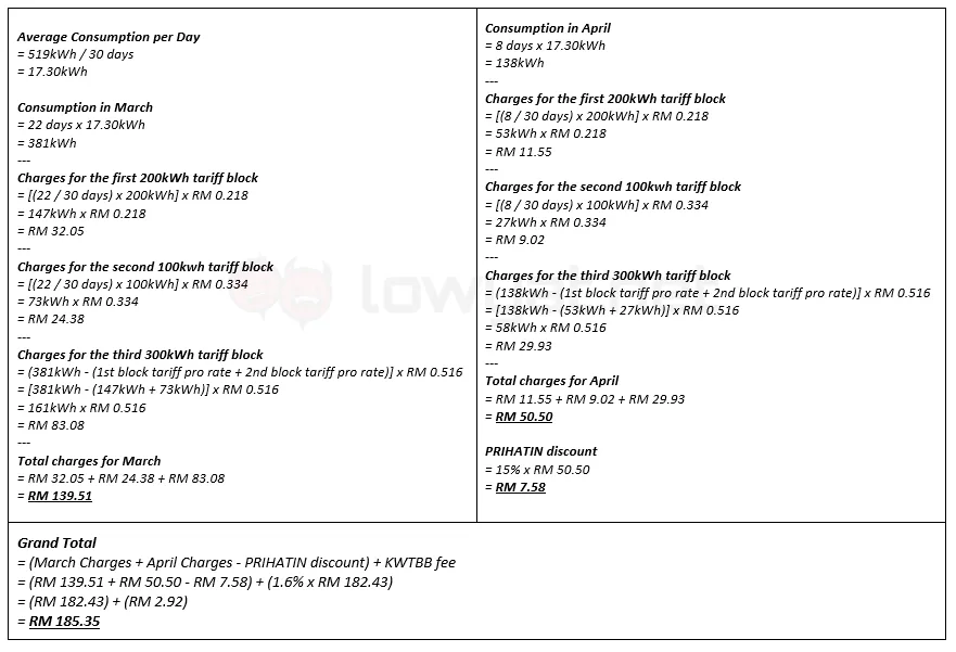

In my case, my home consumed 519kWh of electricity according to my bill in March, which means I am eligible for 15% discount under the PRIHATIN initiative. Now, let us move on to the actual calculation, using the information provided by TNB:
prihatin discount 04
From there, compare the amount above to what that were stated on my actual home bill for April. While my calculation is off by 1 sen in the discount part, the grand total is still right on point.

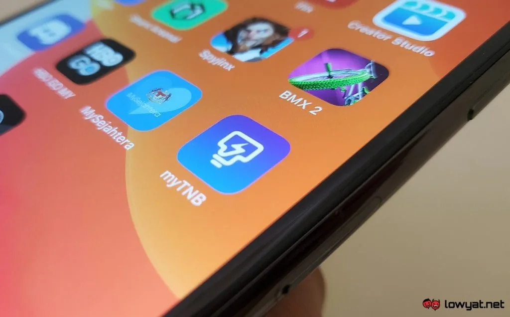

Since TNB is not able to perform on-site meter reading due to MCO constraints and for your own safety, this also means the company is not able to provide physical bill at the moment. So, if you wondering where is the bill and it is already past your usual billing date, do head on to myTNB Portal website or download myTNB mobile app to obtain the digital bill instead.
Meanwhile, to learn more about the PRIHATIN discount for your electric bill, do make sure that you check out tnb.com.my/prihatin.
