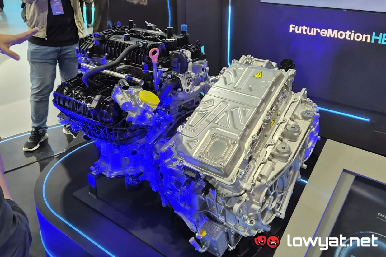

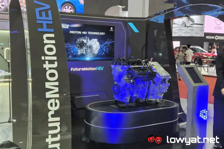

At KLIMS 2026, Proton has unveiled its FutureMotion hybrid EV powertrain tech, as part of its Intelligent Mobility showcase at KLIMS 2026. This is powered by a 1.5l Dedicated Hybrid Engine (DHE), which is paired with a Dedicated Hybrid Transmission (DHT). It, in turn, consists of a P1 and P3 pair of motors, where the former does power generation and takes care of starting the engine, while the latter does the driving.
The engine outputs 82 kW and 136 Nm. Proton claims that it also boasts a 14-to-1 compression ratio, and up to 46.5% peak thermal efficiency thanks to using Atkinson-cycle combustion tech, water-cooled EGR, and a smart cooling electric water pump to help improve fuel efficiency and reduce emissions. RON95 fuel compatibility was also mentioned, interestingly.
Proton FutureMotion HEV tech 3
Working together, the DHE and DHT support four driving modes, switching automatically depending on conditions. These are full EV mode, Parallel mode which sees both the engine and motor working together to propel the car, Series Mode which uses the petrol engine strictly as a generator, and, Direct Drive, where only the engine propels the car.
