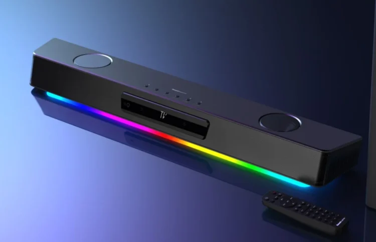

Rasmus Moorats, a cybersecurity expert, recently posted on their blog about their successful attempt to hijack a Creative gaming soundbar by simply reverse engineering its firmware. More to the point, they did that without even having to physically interact with or wirelessly pair their device to it.
The Creative soundbar in question is the Katana V2X, and Moorats says that he was able to gain access to the Creative soundbar by specifically exploiting an unauthenticated Bluetooth interface, sans any firmware signing. Basically, a threat actor would be able to hack into the audio device using custom firmware over the air and transform it into a keyboard that types commands into the host PC that it is connected to via its required USB port.
