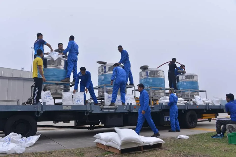

The mixing process.

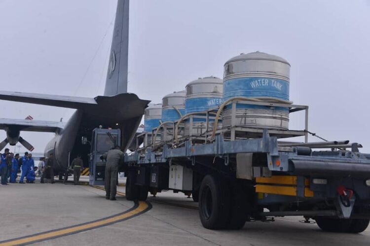

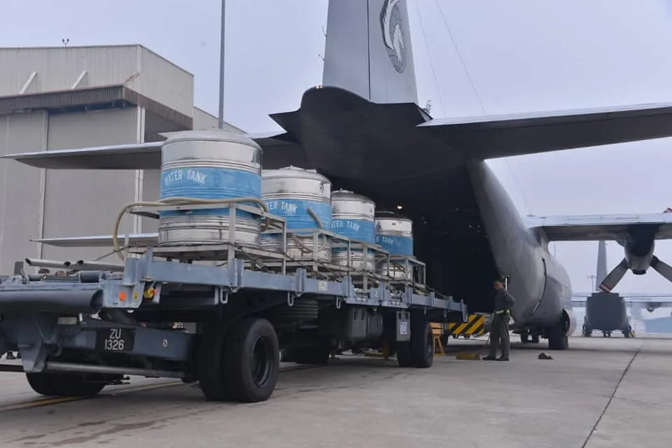

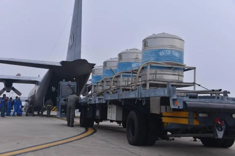

Four tanks of salt and water mixture are loaded into RMAF's Lockheed C-130 Hercules transporter.
Four tanks of salt and water mixture are loaded into RMAF’s Lockheed C-130 Hercules transporter.
According to this handy chart by MET Malaysia, the condition of the atmosphere needs to be analysed first in order to determine the time to perform the cloud seeding operation. The seeding was done using four tanks that contained a mix of salt solution and water.
MET Malaysia pointed out that each tank holds about 200 kg of salt solution which has been poured into 1500 litre of water. All four tanks were carried into the air with RMAF’s Lockheed C-130 Hercules aircraft that was piloted by Mejar Norlela Harun.

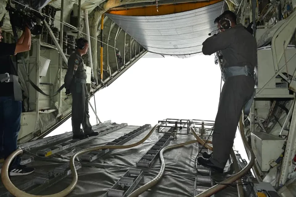

View from the RMAF's C-130 during the cloud seeding operation.
View from the RMAF’s C-130 during the cloud seeding operation.

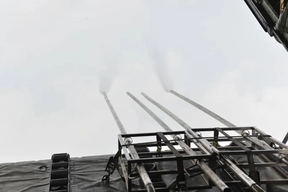

The salt and water mixture being released into the clouds.
The mixture was then released at a height of around 1500 to 2000 meter from the surface although the release can’t be done at any random spot on the sky though. This is because cloud seeding operation can only be performed at areas that have towering cumulus clouds which apparently have a higher chance of producing rain.
Rain would usually take place around 30 to 60 minutes after the cloud seeding operation have been performed. As for today’s operation, MET Malaysia stated that it has resulted in the rain at Cheras, Bangsar, Petaling, Kuala Selangor, Hulu Langat, Klang, Gombak, Seremban, Tampin, Jelebu, Alor Gajah, and Jasin.
