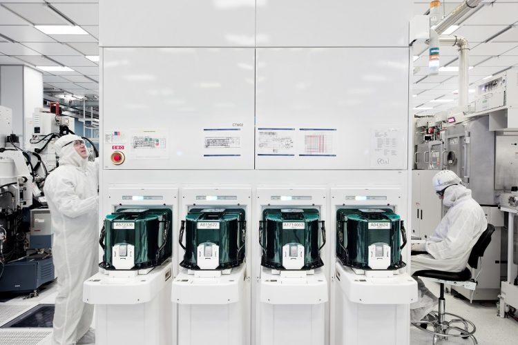

IBM 5nm Test Wafer Preparation
IBM’s research team has managed to create the world’s first 5nm based chip. The significance of this is not so much that the group has managed to shrink the die size, but that it achieved the feat without the use of FinFET manufacturing techniques.
Working with its partners, Samsung and GlobalFoundries, IBM squeezed some 30 million transistors into a space the size of a fingernail. That is 10 million more transistors than the current existing 7nm manufacturing process.

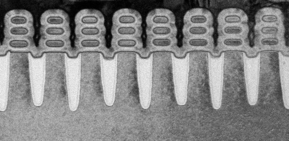

This was done with using gate all-around transistors, which are the next evolution in the triple gate FinFET transistors. It also used true 3D transistor stacking. Current techniques use vertical silicon fins as channels for electrons to travel. Which has problems with scaling as more transistors are added to the chip. IBM’s method instead lays the fin flat, allowing them to be layered more efficiently.
Silicon nanosheet transistors at 5nm
