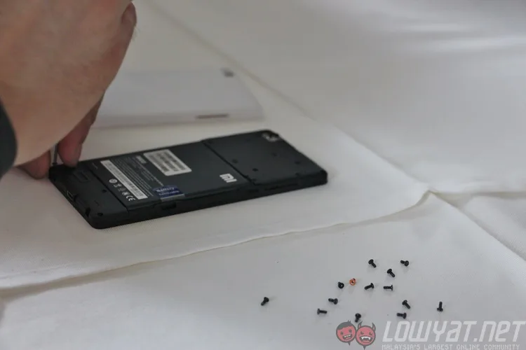

xiaomi-mi-4i-teardown-2A standard Phillips #00 screwdriver opens all the necessary screws required to access the circuit boards. Sung says even the screws were sourced from the best companies that make them.

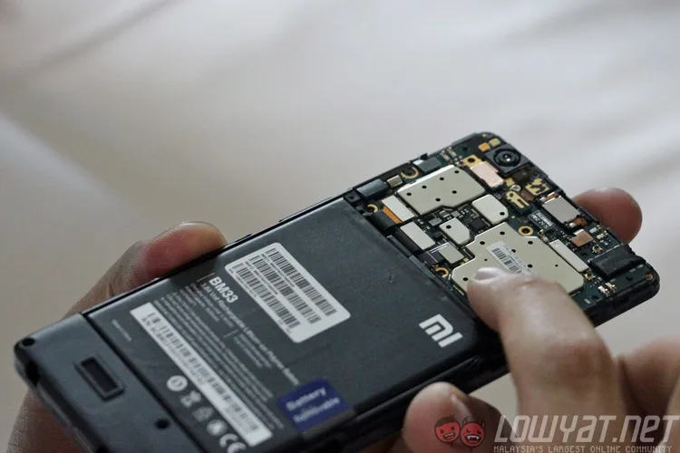

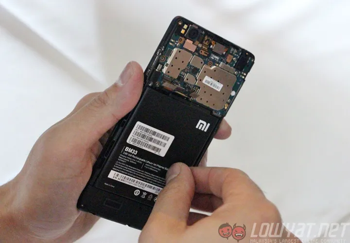

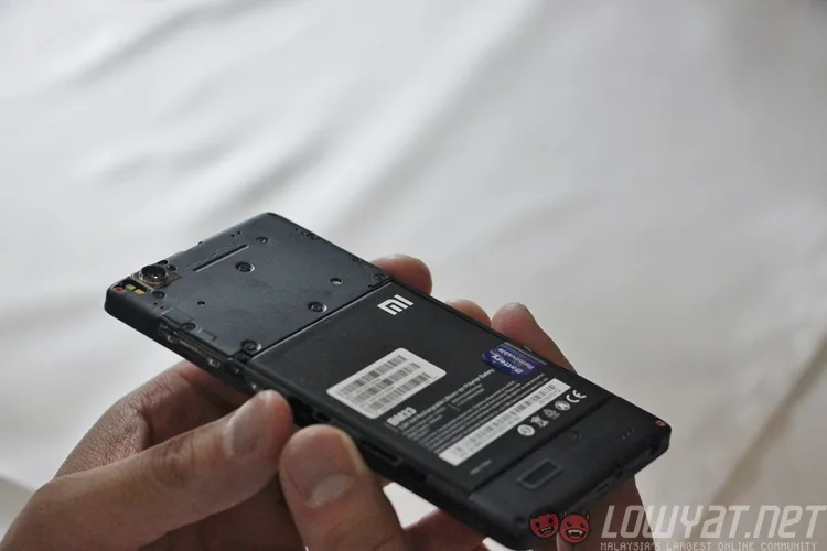

xiaomi-mi-4i-teardown-3The Mi 4i’s battery is actually removable. A little tab near the bottom right side of the device allows the 3,120mAh battery to be safely removed.

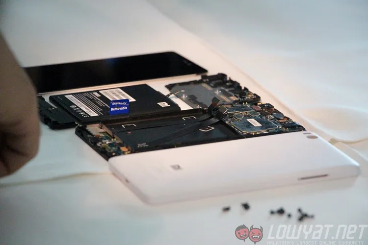

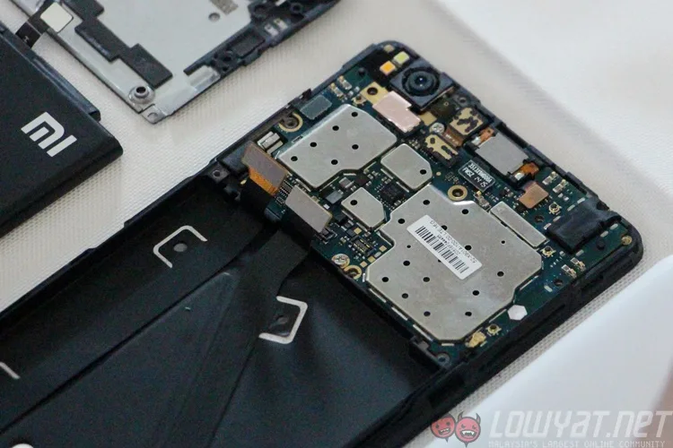

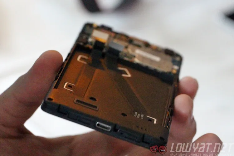

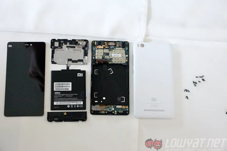

xiaomi-mi-4i-teardown-4The Mi 4i uses two printed circuit boards (PCBs), located at the top and bottom of the device. They’re connected by two strips of connectivity cables, which Xiaomi says is a lot more efficient in design.
xiaomi-mi-4i-teardown-13The top houses the processor, memory and storage modules as well as the camera modules.

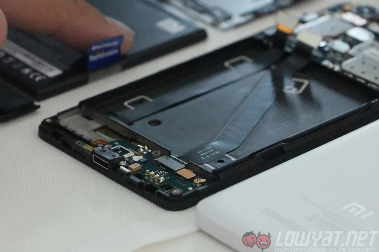

xiaomi-mi-4i-teardown-14The bottom houses the charging module and the speakers.

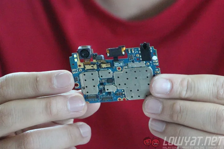

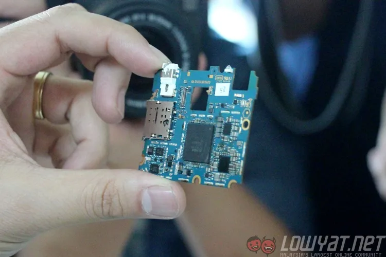

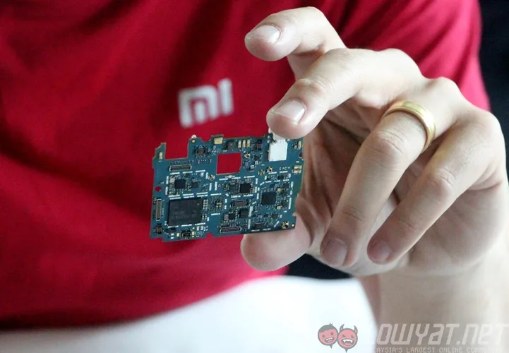

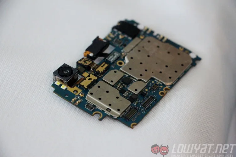

xiaomi-mi-4i-teardown-7The Mi 4i uses a dual-sided PCB, allowing the board’s physical size to be significantly smaller, allowing Xiaomi to fit in a battery that’s as thick as the device itself. (Not pictured: the 13MP Sony IMX 214 camera module – it’s located at the top right of the PCB above, where the square gap is.)
xiaomi-mi-4i-teardown-17
xiaomi-mi-4i-teardown-15The Mi 4i’s PCB, including the camera module. It is the smallest – and densest – PCB ever designed by Xiaomi.
xiaomi-mi-4i-teardown-10Xiaomi patented the “floating” camera design, where the camera module is bound to the PCB via a thin connector, allowing it to fit flush in the final device – no camera bumps.

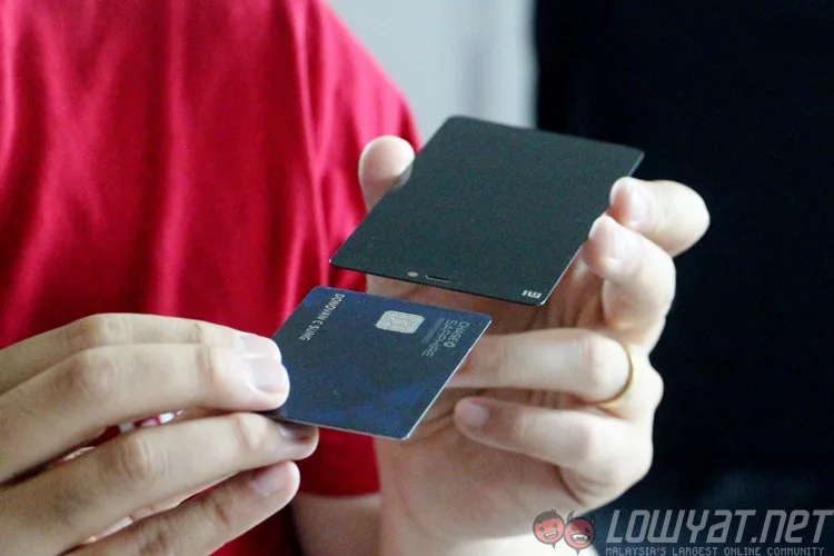

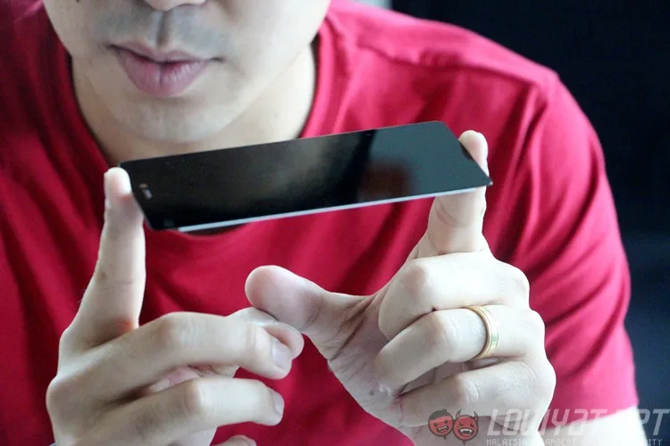

xiaomi-mi-4i-teardown-8Next, Sung shows off the Mi 4i’s display panel. Using an one-glass solution (OGS) panel, what you see above is the Corning protective glass, digitizer and LCD all in one exceptionally thin strip of glass.
xiaomi-mi-4i-teardown-9To demontrate just how thin it is, Sung whips out a credit card – the screen is only marginally thicker.

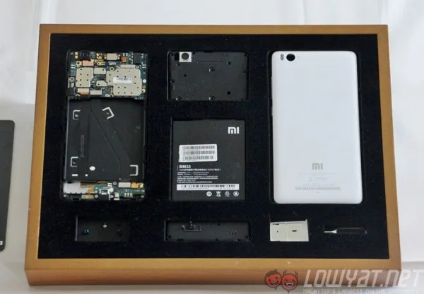

xiaomi-mi-4i-teardown-12After the teardown, Sung casually fitted everything back together, powering it on like it’s something he does every day. He probably does.
