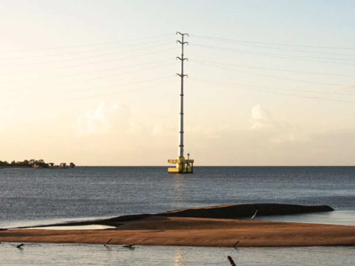

tnb overhead line transmission monopole towers pulau besar
Monopole tower in Pulau Besar, Melaka. Image: TNB.
Previously, TNB has implemented similar overhead line transmission back in 2015 to power Pulau Besar
Related Article Govt Temporarily Increases Electricity Bill Protection Threshold To 800kWh Amid Rising Costs
Download
in Melaka. This particular project involved 12 monopole towers across a 4.2km stretch and only costs RM32.5 million, a stark difference in price compared to the Penang project that is only a little over twice as long.
