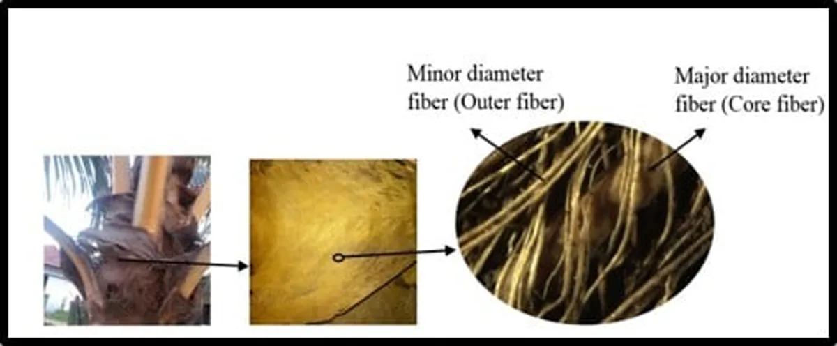

Researchers at Universiti Putra Malaysia (UPM) have successfully produced a multi-layer bulletproof armour from coconut tree frond material or ‘cocos nucifera sheath’ (CNS). The researchers claim that this material is capable of replacing Kevlar on bulletproof vests, without compromising its ballistic resistance.

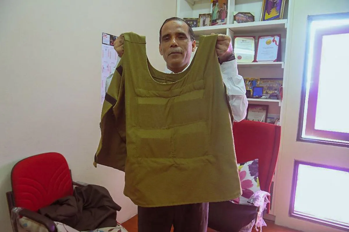

Dr. Mohammad Jawaid holding the CNS-based ‘Techno Economic Hard Body Armor’
The ballistic test was performed using a 7.62mm caliber bullet from a distance of 15 meters, with a shooting velocity of 838 ± 15m/s. Results of the testing revealed that the depth of the ballistic trauma measurement of the CNS-based armour is 26.51mm, which is lower than the 44m blunt trauma limit set by NIJ standards.
Mohammad Jawaid added that production of the armour is able to save 44-percent of fabrication costs compared to those created with Kevlar material. He noted that regular armour made from aramid fibres or steel will require higher thickness levels, which can be heavy and obstruct the user’s mobility. The Techno Economic Hard Body Armor, on the other hand, is thinner and weighs about 5kg.
