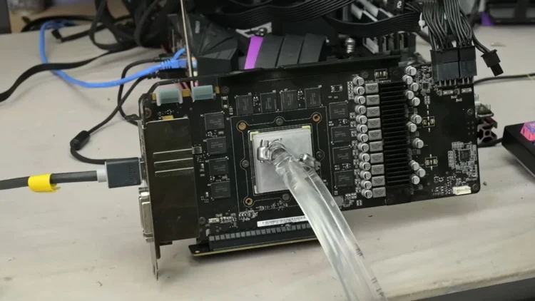

TrashBench has one question: Why do we need metal at all? Why can’t we just pump water directly onto the bare silicon? The stated goal sounds simple enough, as least in practice: create a custom 3D-Printed GPU “waterblock”, sans the metal block that usually sits on top of the silicon, and make sure that the pump doesn’t leak.

But simple sounding is obviously not as easy as it sounds. TrashBench’s first objective was to create the leak-proof waterblock. For the first trial and error phase, he used an already dead NVIDIA RTX 3060, making sure that he had a solid enough prototype that wouldn’t cause an electrical fire mid-testing.
The good news, for TrashBench at least, is that they did create a workable direct-to-die model, which allowed them to move on to a second working card which, in this case, was a GTX 980. This was still the trial and error stage; the clear plastic they initially used wasn’t suitable and began leaking everywhere the minute water began pumping through it, permeating through the plastic of the bracket.

A couple of tweaks to the 3D Printer settings, though, some reapplied nail polish, and epoxy to attach the cooler to the GPU, and they got it running. With that, they moved on to the next part.
