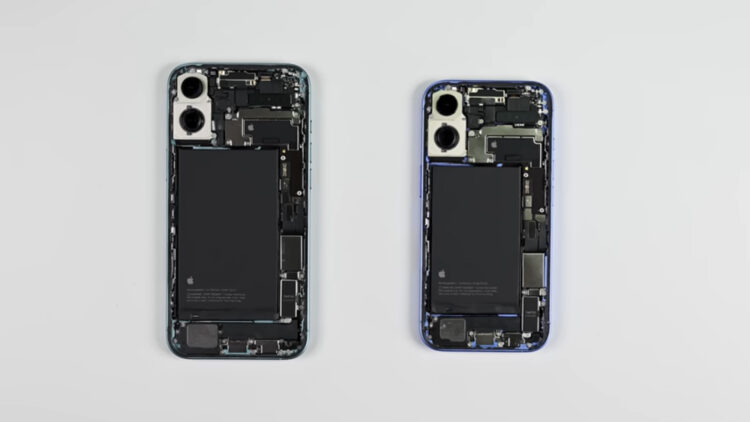

Apple has introduced significant repairability improvements with the iPhone 16 lineup, particularly with a new battery removal process in the base iPhone 16. Instead of the traditional pull tabs, the company is now using an adhesive that debonds when exposed to a low electrical current.

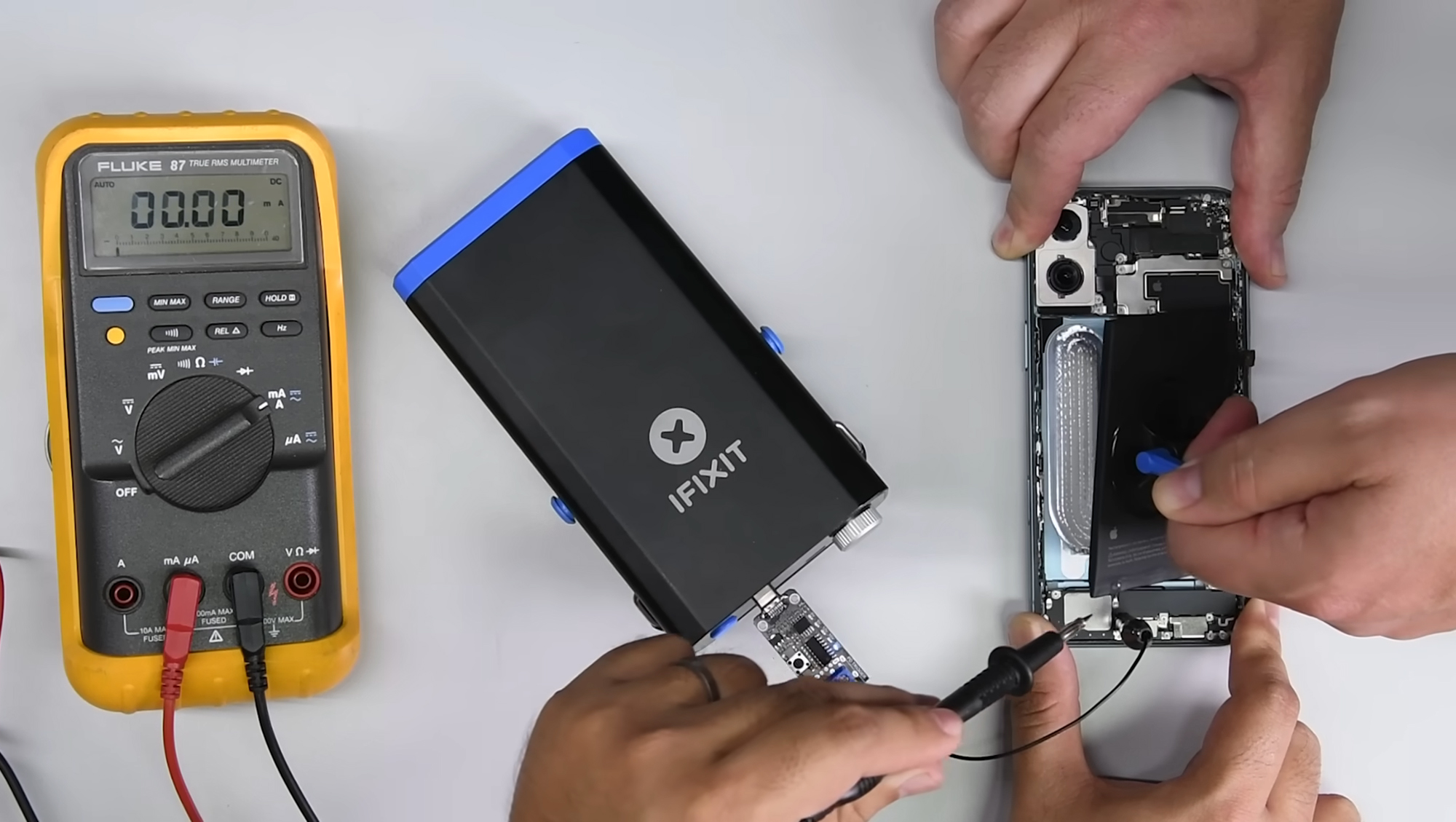

iFixit has demonstrated this in a teardown video, showing how a low-voltage current is applied to release the adhesive, allowing the battery to cleanly pop out of the phone’s chassis. This new method simplifies the removal process considerably.

The new electrically-activated adhesive eliminates these risks. Now, all that’s required is simply attach alligator clips connected to a power source, and the iPhone battery is released without any manual effort. According to Apple’s repair guide, the process takes just a minute and a half to complete.

However, this feature is limited to the iPhone 16 and iPhone 16 Plus, which have earned a 7/10 score on iFixit’s repairability score. The iPhone 16 Pro and 16 Pro Max still use pull tabs, although their battery cells are now encased in a new metal enclosure.
