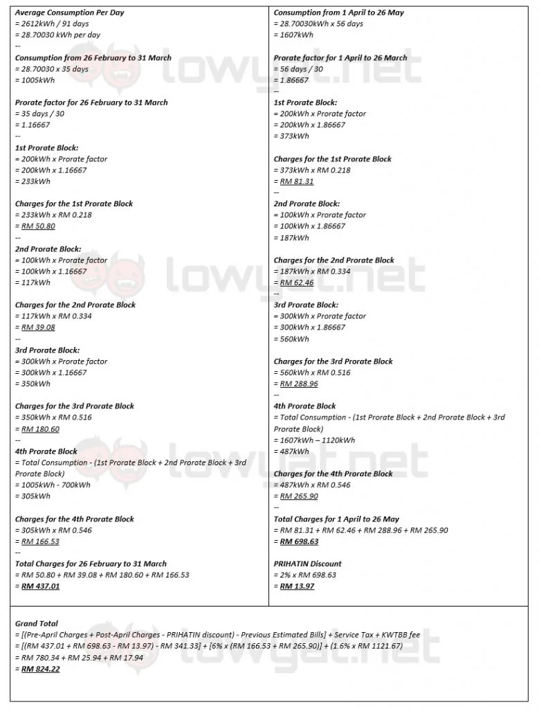

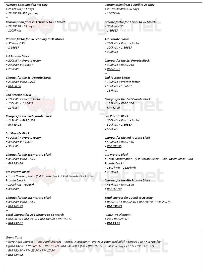

So, let’s have a closer look at how TNB ended up at that figure. Let’s say that the duration of your latest bill covered the period between 26 February to 26 May which equals to 91 days. According to the actual reading from the power meter, you have consumed 2612kWh throughout that duration.
prihatin tnb 01
Do you still remember the PRIHATIN discount? Well, then you might be aware that the discount is only given to power consumption that takes place after 1 April which means you have to consider the non-discounted period into your calculation since the duration of your bill starts before 1 April.
Aside from not having any outstanding payment, it has also been stated in your latest bill that your total Estimated Bill during the MCO period was RM 341.33. With these figures in mind, this is how your latest bill would approximately look like:
tnb bill adjustment may 01

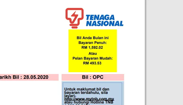

Furthermore, you do not have to do anything to sign up for this EPP as it is being applied automatically to all 7.5 million residential customers of TNB. If you want to take up the EPP route, all you need to do is just pay the initial EPP amount that is being shown in the yellow box at the top of your latest TNB bill.
tnb epp yellow box 01
As stated on TNB’s website, the initial EPP amount is 31% of the bill. In the case of the sample calculation that we used above, that means you can choose to pay RM 255.51 first instead of RM 824.22 if you want to spread the amount until the end of the year.
