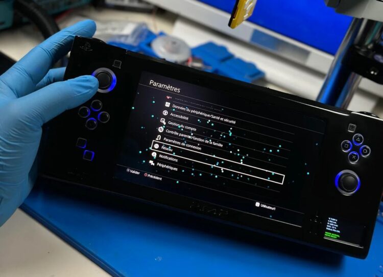

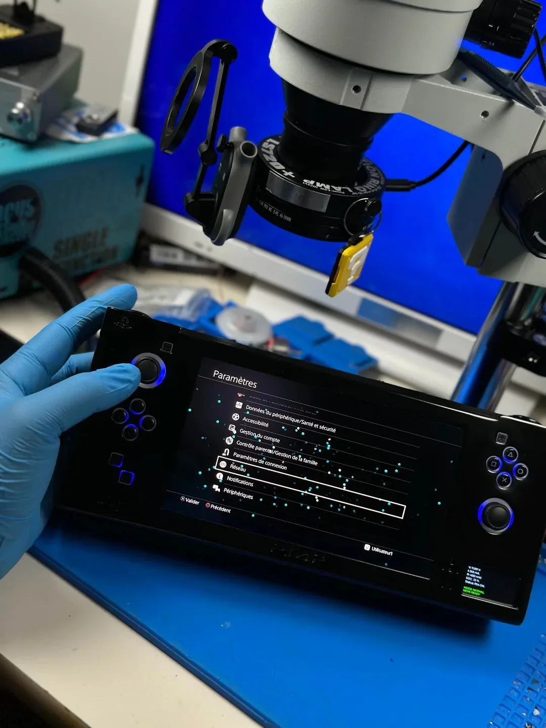

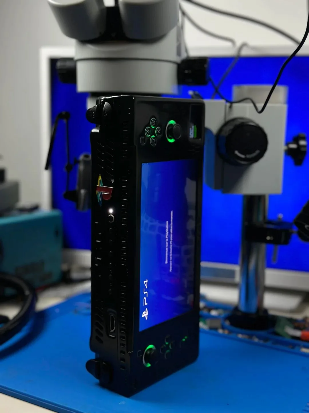

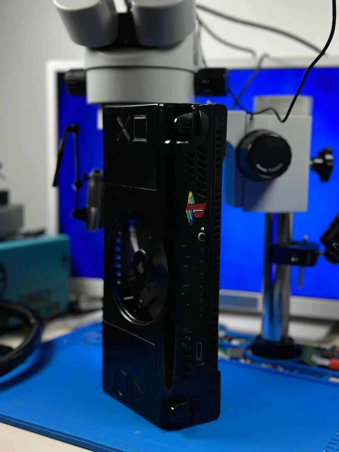

In light of the growing popularity and trend of gaming handhelds, a modder in the DIY console modding scene recently showed off the fruit of their labour, having “successfully” transformed their Sony PlayStation 4 Slim (PS4 Slim) by shrinking down just enough to fit into the palms of their hands.
The DIY project was posted on the subreddit r/Handhelds by wewillmakeitnow, and reportedly took months for them to get it to the stable build that allows the “handheld” to be fully functional and safe to use. Note that they did not say final, as they also explain in their Reddit post that this was a passion project and a personal engineering challenge, suggesting that further tweaks to the design and overall build could be made to it, in time. So, if you were hoping for mass production, you’re out of luck.
How The Franken-Handheld Is Made
1 of 3
wewillmakeitnow gave a list (sort of) of the components that he used and, obviously, reused, in the making of the PS4 handheld. It’s a bit messy, but we’ve cleared it up the best we can and made bullet points of it below:

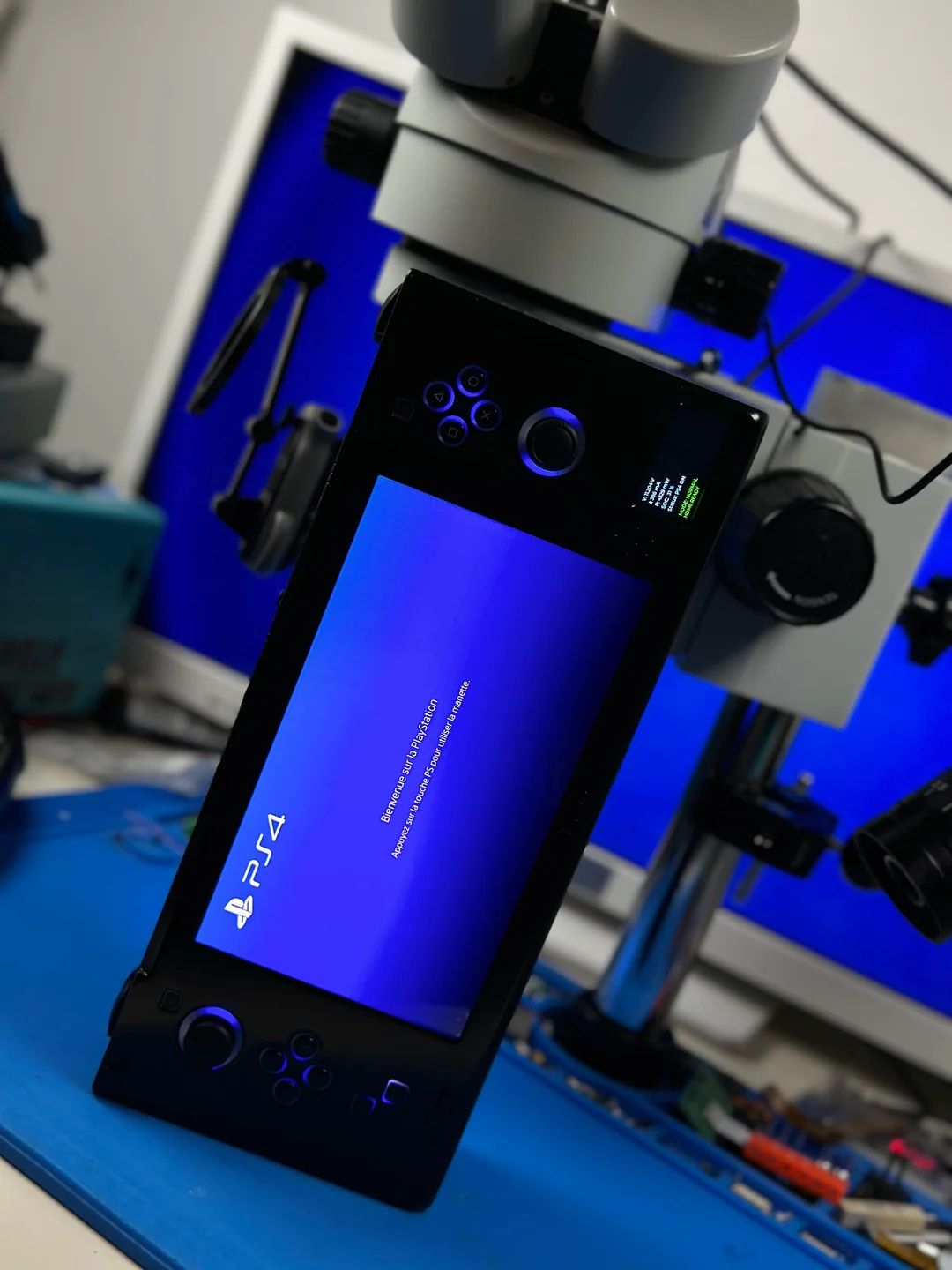

  • Miniaturised PS4 Slim motherboard: The original motherboard was carefully studied, then cut and modified to make it as compact as possible, while keeping full functionality. The goal was not only size reduction, but also better power efficiency and thermal behaviour by optimising the layout and removing unused sections.

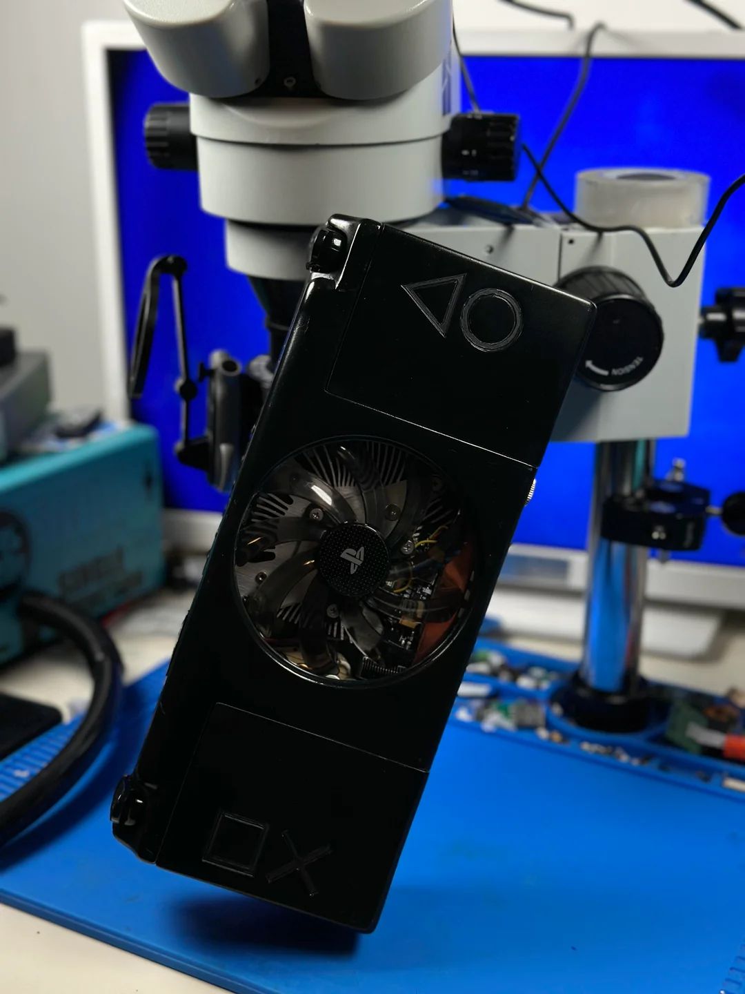

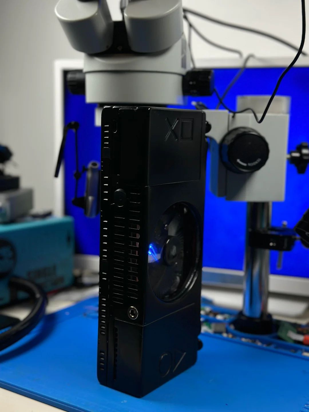

  • Redesigned cooling system Optimized airflow and heatsinks with active temperature management to properly handle the PS4 APU under load.
  • Integrated ESP32 microcontroller (custom firmware) Used for: Real-time temperature monitoring, Safety management (thermal thresholds, emergency shutdown), Power consumption monitoring, and battery charging supervision
  • 7-inch OLED display – 1080p (16:9) High image quality, excellent contrast, and low latency.
  • HDMI output allows the console to be connected to an external TV like a standard PS4.
  • Battery system & autonomy: 6× 21700 cells – 6000 mAh each (3S2P configuration) • Approximate energy: ~130 Wh
  • Estimated runtime: Low / medium load (~4 A) → ~44 W consumption → ≈ 2.7–3 hours of gameplay
  • High load / demanding games (~8 A) → ~88 W consumption → ≈ 1.3–1.5 hours (System performs a safe shutdown at ~10 V to protect the battery.)

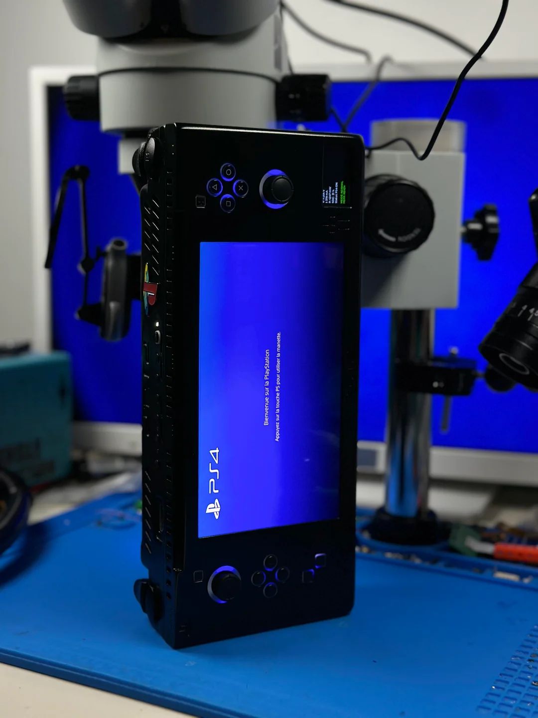

Breaking down the connectivity, wewillmakeitnow says that they managed to fit an HDMI output port, three USB-C ports, an ESP32 microcontroller, a port for console charging, one direct connector port, either for a controller or external drive; a USB-A 3.0 port, and a dedicated port for playing while plugged into AC power.
Off the wall, the Redditor says that their PS4 handheld can give up to three hours of gameplay, and that’s with an average power consumption of 44W, which they claim is the low to medium operating load.
For more demanding titles, they say that the handheld caps out after 1.5 hours, and a failsafe they put in shuts down the console at approximately 10V, to protect the battery.
Sadly, wewillmakeitnow only provides pictures of their handheld, and there’s no video footage of it running.
