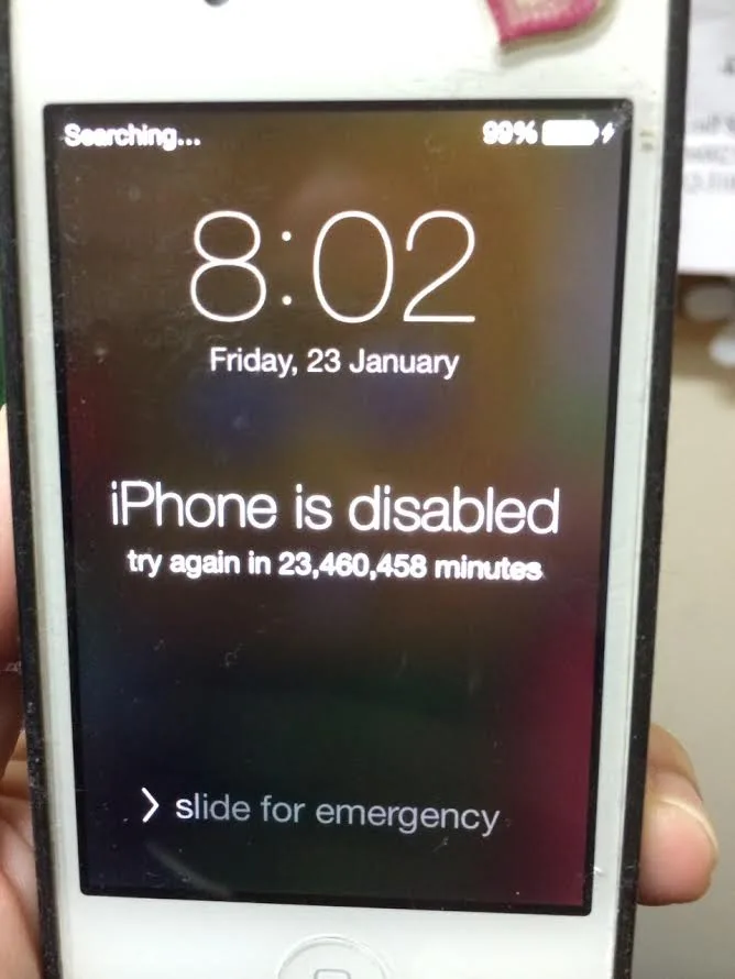

When a user’s iPhone or iPod passcode has been entered incorrectly, the device will show a message saying “iPhone is Disabled”, prompting the user to try unlocking the device after a few minutes. Occasionally, some users would even receive a message asking them to try again in 23 million minutes – of course, that would actually translate to 44 years. Here’s what to do if you can’t wait that long:
The reason to why this is happening is simple, either the user or a prankster has entered an incorrect passcode on the device one too many time. A passcode is the security measure which requires users to enter a four-digit pin in order to unlock the device. If an incorrect passcode has been entered consecutively for six times, the device will lock itself. It will only let the user re-attempt entering the correct passcode after a specified amount of time.

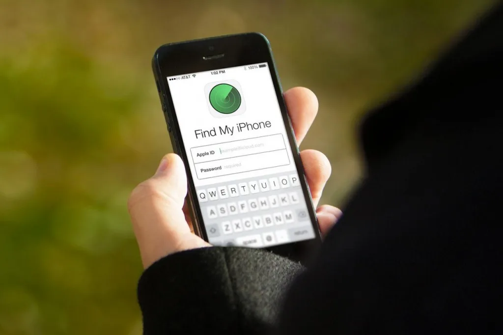

Find My iPhone Method
Find my iPhone
Let’s say the user is out and away from a computer. The first thing he or she could do is to ask a friend who has an iOS device for help. To do this, the user’s disabled device needs to have iCloud enabled and the other iOS device needs to download the Find My iPhone app. Once that’s done, just log in with the iCloud credentials, find your iPhone and perform a Remote Wipe (Note: This will delete all of the user’s data, but if they do have backups done before, then it should be fine).
